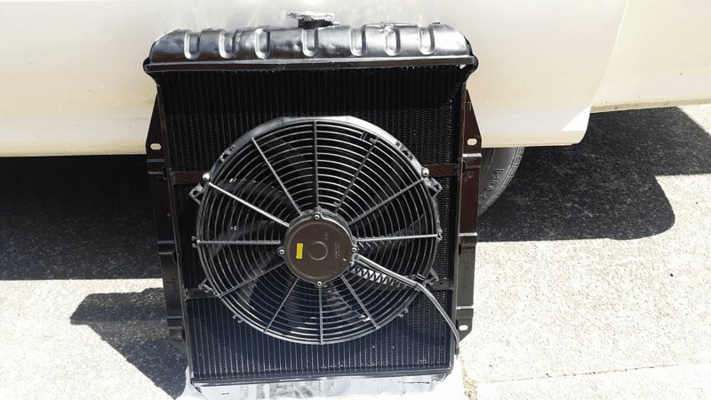

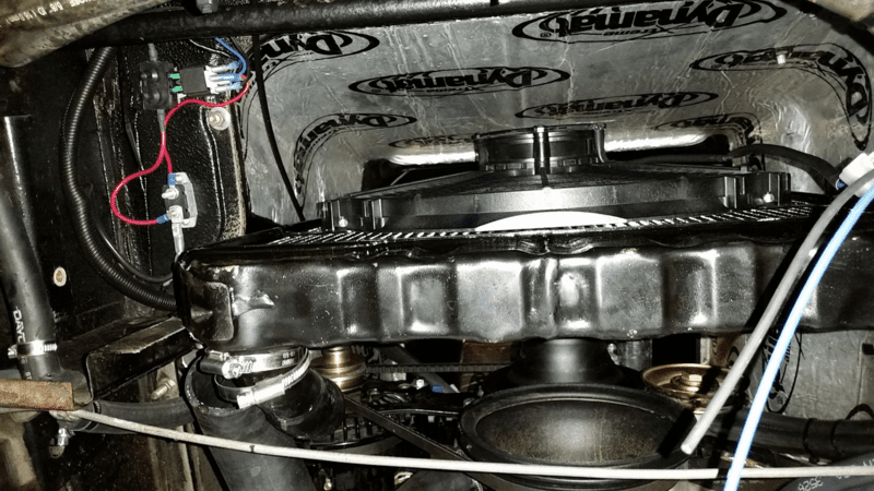

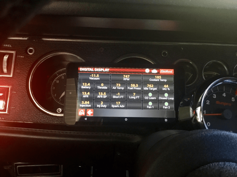

I have an electric fan connected to FAN 1.....it switches the fan on at a preset of 190deg. I also run my 5 blade on a clutch unit with a shorty Hayes .....can show pics tonight.....at work right now. I have a video of my Sniper running and you can see the temperature flick over at 190 and see the Fans come on.
Check this out at roughly 6min mark onwards. Wiring is easy....I used a 30amp relay near the fan.
Fan feed from Sniper loom is the relay switching GROUND.
