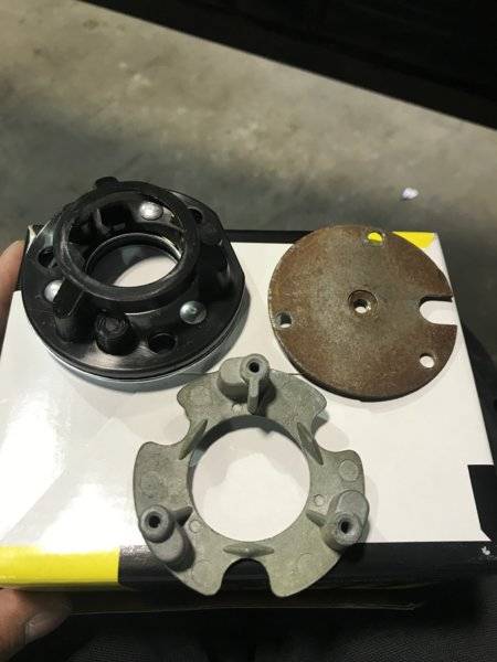

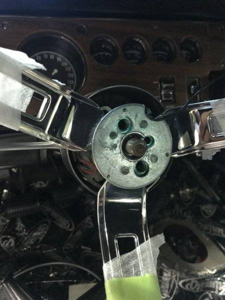

Hey Guys I Ordered a Factory Style Woodgrain Wheel For My 1969 Charger.
Just Wondering How It Goes Together. I Know Now That The Horn Pad Twists Into The Metal Bracket But Not Sure How The Horn Button Gets Attached.
Do I Need To Reuse Any Of My Old Parts?
The horn contact screws to the twist on attachment from the back side of the horn contact. Then 3 screws from the front mount the horn contact to the wheel. Connect the wire to the horn contact, twist on your horn pad and done.
Those parts in your picture won’t be used other than the horn contact, if that’s the right one. Hard to see in the picture?
I Have That Piece. I Got a Few Pics Im Going Off Of Another Member Sent But Any Other Tips Or Advice I Will Always Use. Thank You
