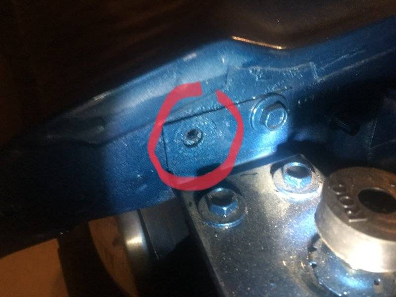

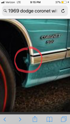

Not my car or picture. I missing these fender bolts and need to replace. Does anyone know for sure, it’s size ?
5/16x18. 1 1/4 long if I remember correctly
5/16"x 1". 1/2" wrench.head markings vary. on a dodge application, the longer 1-1/2" bolt may inner fear with the inner fender/splash shield.

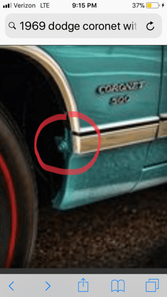

Another bolt size question. The two bolts that attach the front grill cradle to the front fenders. You can see in the picture the bolt size I need is missing and circled in red. Thank you
