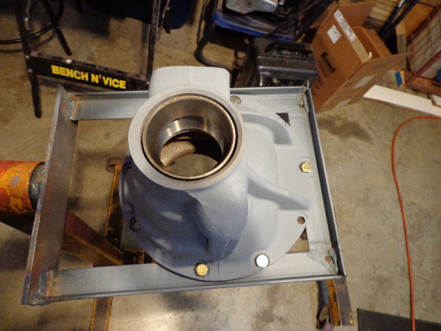

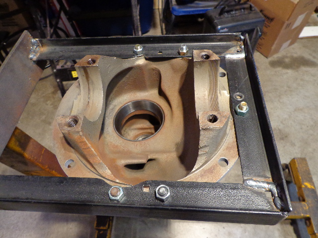

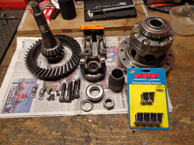

I'm currently going through a 489 3.91 geared unit with a brand new Mopar Perf. sure grip. Should have it done tomorrow or Tuesday. I hot tanked the 489 housing, checked all the bearings. Was told it was just rebuilt with new Timken bearings and it was. Only reason I'm going through it was the brand new Mopar perf. sure grip unit was one of the defective units that got through and didn't last but 5 runs until the spider gears broke. It was disassembled and a new set from Dr. Diff installed that were hardened. The gears are factory 3.91 gears that were in great shape and are the heavier duty fine spline gearset. I also installed a new 7260 (small U-joint) yoke as the original had a small groove and I didn't want it to leak. Also installed a crush sleeve eliminator kit and used a new set of ARP ring gear bolts. It is in high temp engine primer and I can paint it either black, cast coat grey, silver, Mopar engine red. The buyer decides. I guarantee this is a premium unit that will take a lot of abuse. Here a few pics of when I had it cleaned up ready to assemble. If interested PM me. DSC00222.JPGDSC00223.JPGDSC00225.JPG
