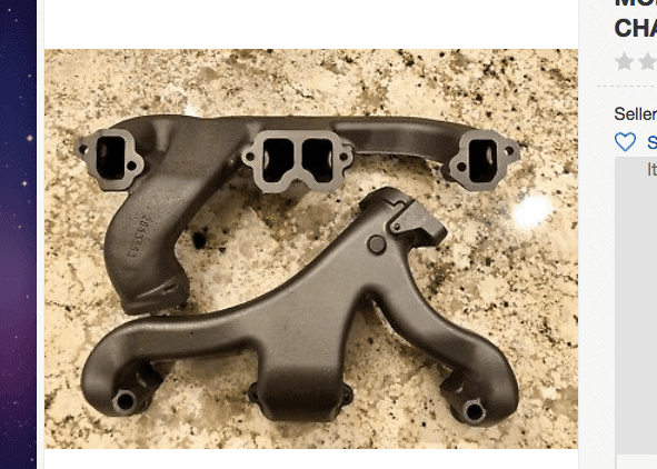

Do these 340 A body exhaust manifolds fit a 71-74 BBody with power brakes and power steering? If not, has anyone tried to fit/adapt them? Thank you.

I was not aware they were reproduced, no reason to worry about winning an ebay auction then. Does anyone have any details regarding the ease or problems of using such manifolds on the Bbody?
Had those on my ‘73 RR. Fit fine, but still damn tricky to bolt up the down pipes. Now got TTI step headers, much better all round.
