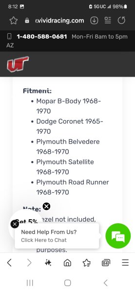

I was on a site that sells dakota digital stuff and they claim this dash works from 65 to 70 in a coronet. Anyone used one with success in a 66 coronet?

Vivid racing lists it as being for 65 to 70 coronet but belvedere is 68 to 70

I would trust what Dakota Digital says VS any other site. Why not get it from the source.
I sent them an email, I was hoping someone on here had actual first hand experience.
Heard back from DD, and they say it doesn't fit. So I called vivid racing and spoke with a tech guy there about their ad saying it fit 65 to 70 coronets. He said yeah, that needs changed. He said, you can try it, but you may not be able to return it. So I may look for a 68 or 69 stock cluster and see what the differences are.
