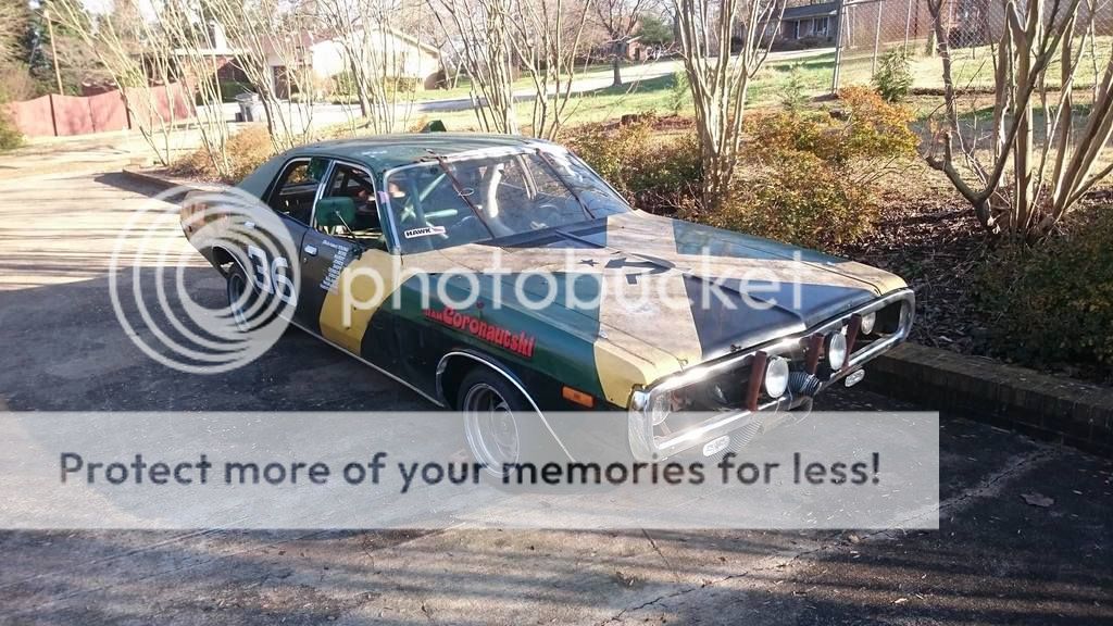

Well taking the ar5 plunge. We have sourced a bellhousing and the transmission. Next up is to pull the engine out and mate up stuff on the bench.
I will do a write up later. However anyone who may have been following this thread this happened today.
Ar-5 behind a 318 in a 72 Dodge Coronet.
