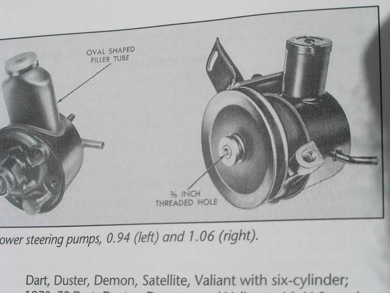

73 Roadrunner - both Saginaws but reservoirs are different - are either correct ? Both styles come up when doing part search, mine is like the one on the right but when ordered, I got the style on the left .....

They made 2 different style pumps in most of the 68 thru 74 cars.
Key slotted with oval neck or the threaded hole with the round neck
Yours was the key slotted. They do make rebuild and seal kits for them.
The one on the left appears to be for a much later model car.
Guess I need to research some more, it'll work but ...................
