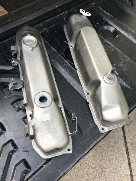

are these 1970 valve covers?

Listed as 73-76 They look like 70. thanks dave
Theses reported to be 69.

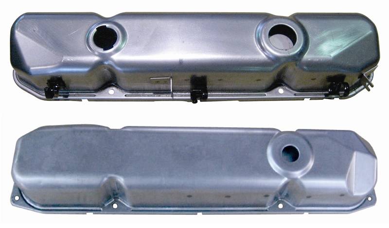

Actually the raised covers are 76-78 as the OP shows. I have a 74 B 400 and had 2 75 BB trucks and they had the flat covers.
Have had a few 76-78 BB trucks and they had those raised covers.

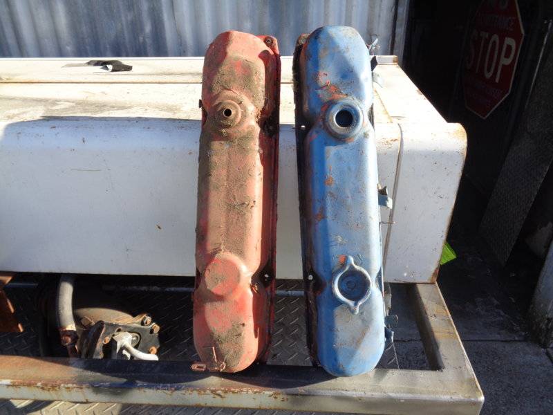

Pomonamissel and Dennis H are showing the 70 style. Actually the left one that Pomonamissel shows with the pcv is a late 70-71. Early 70 didn't have that raised circle.
68-69 have a large nipple for a push ON breather cap. 70 went to a rubber grommet for a push IN breather cap.
These are early 70, i believe late 70 and 71 are the same

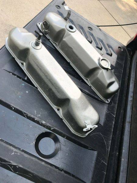

this says 1970 valve cover
