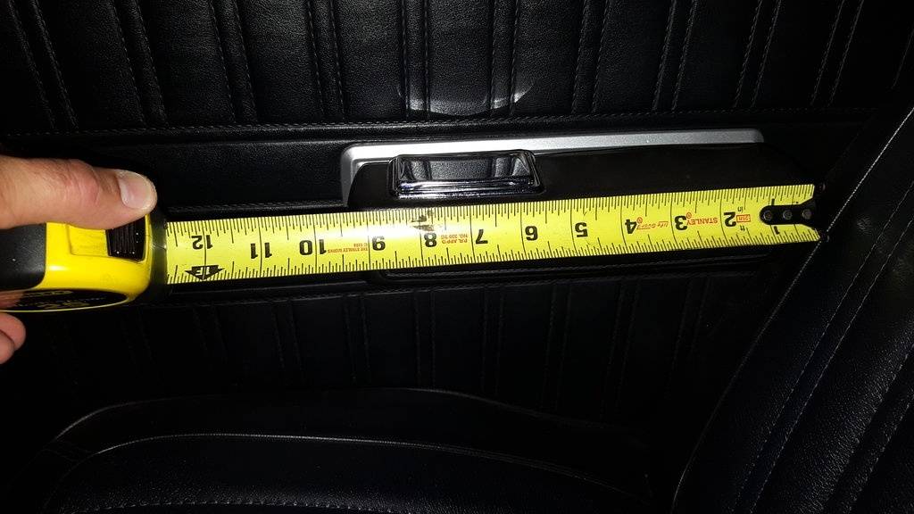

Not quite, the fronts are re-pops and the rears are original with the ash tray. Both measured exactly the same !
Repops are notorious to be an incorrect length(other issues with them as well)...Made in China junk....

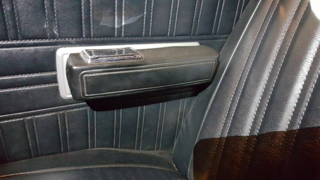

Also haven't seen a repop 9" for rear w/ashtray. AND guess what my originals have mounted in frt edge,,yup ashtrays.

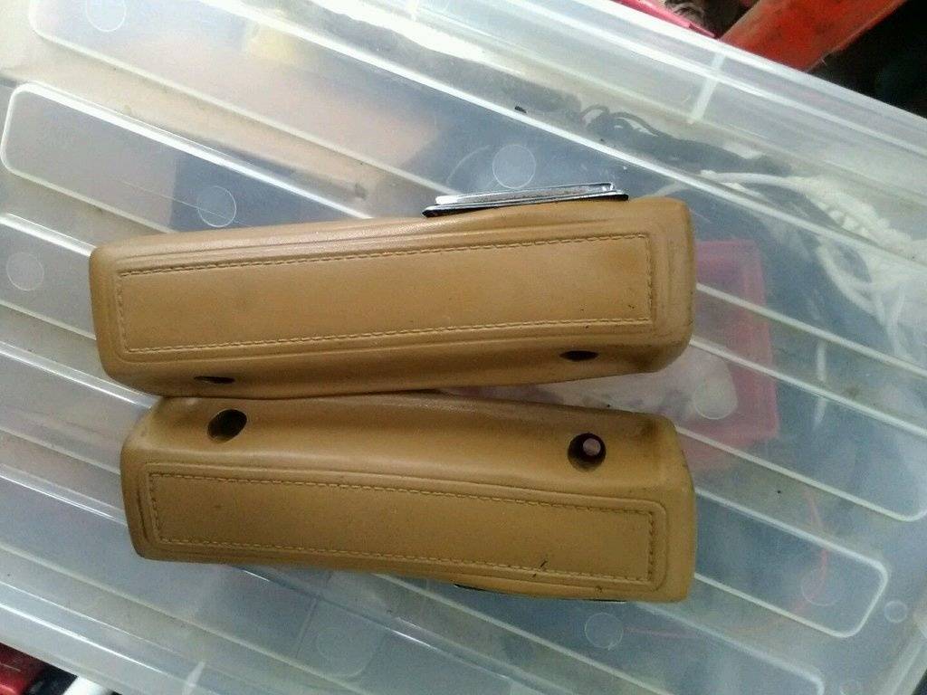

Well that's a shitty move from that dude ..... I'm pretty confident my rear pads are the original 68 coronet pads ....
here is the rear
Thats why you have to be very careful buying NOS parts....Some sellers are very honest and some are very dishonest or they themselves don't know....NOS buyers like myself have done years of research and know exactly which sellers one can buy from with confidence...The others requires research and asking others familiar with that market...
The backside of that arm rest will tell if original or not but based on the pic you posted it is a 68 pad....Keep in mind moulding then is different now it was not perfect...It is actually 9.25"...The rears with ashtray budge out due to the ashtray area....Some say it shrank a quarter inch...True if were talking dash pads but the foam on the arm rests are different. It doesn't really shrink but get hardened...
Notice the bulge on the first pad to the right...Due to the ash tray area...
