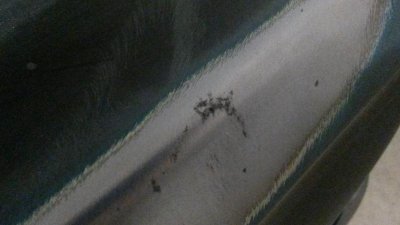

It should work on these little spots huh? I tried to dig them out but it wasn't much help. Nervous to go after it with a dremel.
