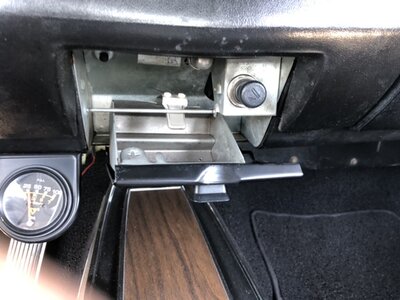

My daughter pulled my ash tray out of the dash on my 1969 Coronet with a 150 square speedometer. I cannot get it back in. What am I missing?

See the rib on the bottom of the tray? It hooks over the rod in the frame.
The ash tray rides over the rod. The v in the ash tray goes on top of the rod. Then the spring is held down until you lock into position.
