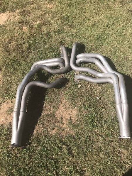

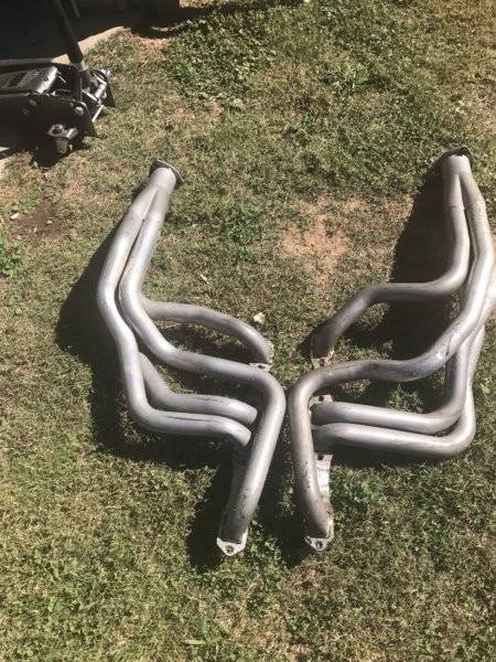

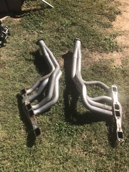

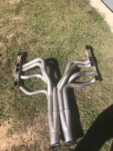

Best bet is to buy some pre bashed headers I have a set for you.. TTI 1 7/8 primaries all ready hammered to fit.
