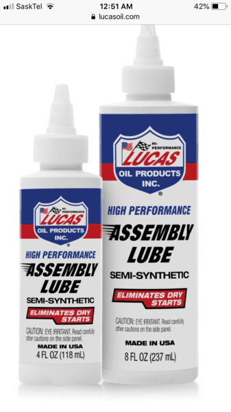

Lucas Oil.
https://lucasoil.com/products/problem-solvers-utility/semi-synthetic-assembly-lube
I've used the Lucas stuff that's listed above on the last two engines I put together. As long as you use some type of assembly lube and use it liberally you will be fine.
