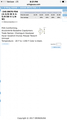

Greetings all wrench gripping, knuckle bleeders! Mr. Belvedere here with a question for the ever knowledgable! I have handily removed my PS pump and stuffed it's leaky contents into a paper bag where it will almost certainly be depositing its wondrous claret fluids on the garage floor. I plan on removing the reservoir and replacing the O-ring to stem the hemmorage of ps fluid onto my kmember. I was reading an earlier thread that spoke of a TRW pump and the Oring to seal it. Thinking my pump was a TRW I went and purchased a 245 bn70 Oring only to find that my pump is a federal pump. Will the TRW Oring also fit the federal reservoir??? Also, what is the preferred method of removal of said reservoir from the pump itself?
The outer pump body o ring actually works. But the inner shaft seal that likes to leak on the federal pumps is different for sure.

Awesome! This is just what I wanted to hear! My shaft seal is fine, it's the leaking reservoir housing that has been dogging me. You have put my worried mind at ease, and for that I thank you graciously!
