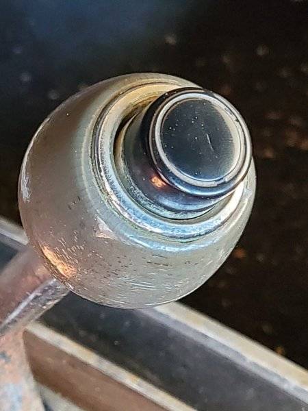

I'm having trouble removing the shift knob from my 69 Road Runner auto console. I removed the allen screw and when I try to unscrew the knob it just turns. I looked at the Service Manual to see if I was missing something, but it says to remove the allen screw from shift knob then unscrew button, spring and knob assembly from cable end and remove from lever. What am I doing wrong?
You turn all of it. the wood knob and all. Approx 3-4 turns and it’s off. The black button screws to the cable inside.
the knob has a raised rib that rides inside a channel in the wood ball so they all turn together.
How did you end up getting the knob off, break the button?
Pull gently as you unscrew the knob assembly - if the threads are stripped, pulling and turning at the same time will help.
