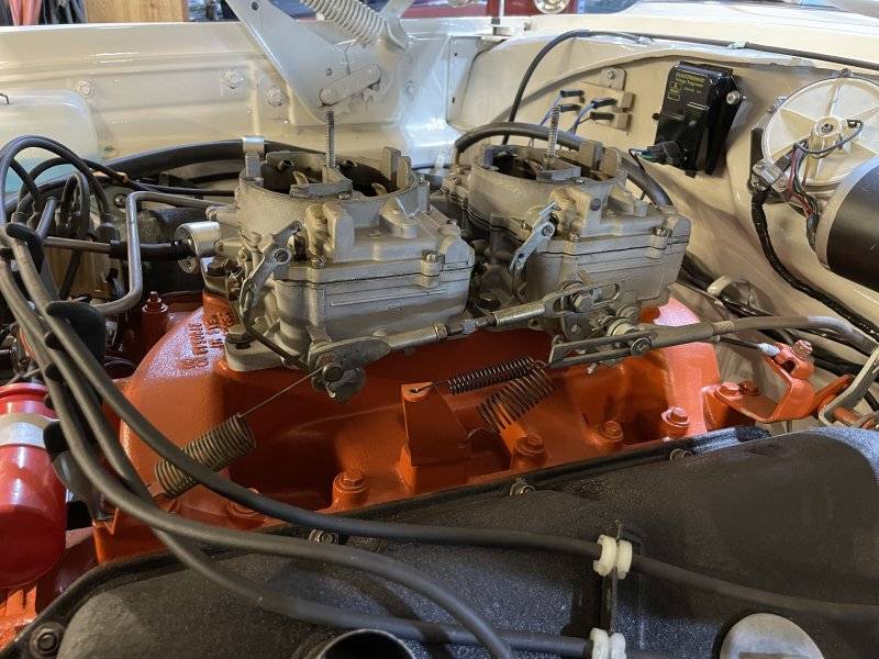

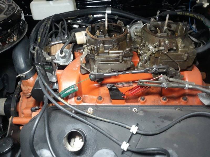

Does anyone have a picture of the factory installation setup of the two throttle return springs and the automatic kickdown return spring?
it’s for a 66 Belvedere Hemi automatic with dual 4 barrels.
Thanks

Perfect! Thank you very much…
Ps, on mine Im not 100% sure but I think the link connecting the 2 carbs . the slot should be towards the front . not like the it is. ive just never worried about it enough to change it. In all honesty, this is the 1st time the air cleaner has been off in nearly a year.
Mine is set just like yours, looks like I need a different linkage for the kick down
