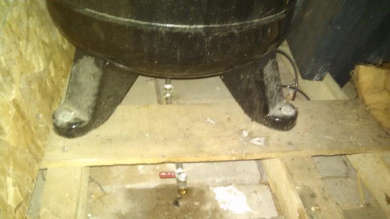

Ours failed too after a short while...heres what i did but I have a separte room outside my garage with a gravel floor...and you can see I just drained it IMG_20150307_212914_766.jpg
