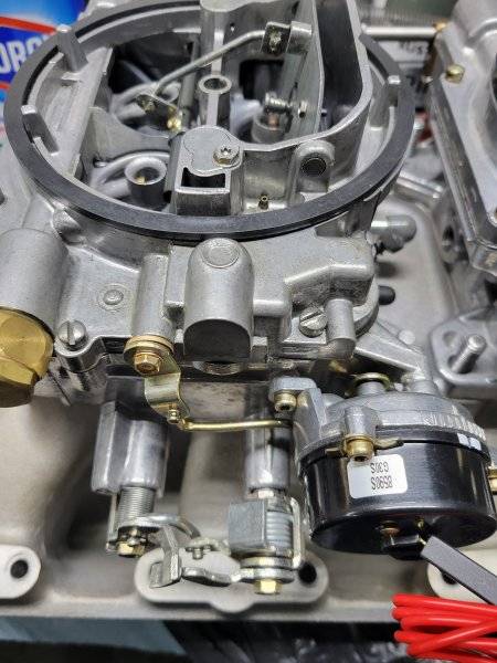

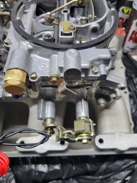

Here are pictures of my #1405's. One picture is the stock carb, the choke seems to be frozen open, non functional. The other picture shows the same #1405 with the #1478 electric choke kit, they are dual quads on my Hemi. The choke kit replaces the shaft, and levers. Red wire connects to 12 volts through the ign. Do not attach to the coil.

Post #6 shows a pic of an AFB carb. The AVS carb has a spring loaded air valve above the secondaries & are rated in 650 or 800 cfm. What have you got?
I have a 400 engine thinking about going with Eldelbrock 1906
Post #6 is a #1405, not an AFB.
The #1905 & 1906 carbs are AVS carbs [ Air Valve Secondary ].
The carb in post #6 is an AFB carb.
