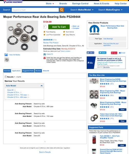

Hello gentleman, I’m in the process of adding a new gear ratio to my 67 Coronet and I pulled the axles out and see that the axle bearings are junk. I found a set on summit racing and was wondering if anyone could tell me if these would work on my car . It has the 8 3/4 with the 741 case. This set says it will fit on a 742 case but doesn’t mention the 741. I’m very new to working on axles and I know this may be a dumb question. I would assume the axle bearing would have nothing to do with the case # , but as I have learned working on my Mopar, everything is unique and different from Fords and Chevys, which is part of the fun.

Yeah axle bearings are the same on all 8 3/4 rear ends. Those are what are referd to as green bearings. They are sealed and don’t require the adjuster so you can leave it off. They’re work great and are what most guys use.
Do NOT buy those! They are garbage!!!
Call Cass aka Dr Diff, and he can set you up with the good green bearings or the factory style Timkens.
Second the OEM Timken style tapered bearings. I had green bearings and most of the grease squeezed out of them in less than 1K miles, thankfully I caught before they went dry. The adjustment on tapered bearings isn't difficult and doesn't take that much time to complete.

He’s got both style of bearings. And just to put this out there, Timkens are not the best for axial loads. We all know that the Ferd 9 inch is used in everything, and they are not a Timken style bearing. Yes, they are great, work good and last a long time. I did was just giving the OP a place to get either style and talk with someone that knows their stuff, not try to sell ya on one or the other.
Thank you for all the education. I’m going to do some research and try to read up on all my choices before I make an order. I’m leaning towards the oem style as I don’t want to do a lot of adjustments, as I am learning all this as I go.
