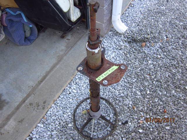

Have a 67 column shift column plus a wheel but need to check if power or manual steering. Think it's power. $100 plus the ride.
I'll get to the storage unit in the am and get a pic or two. Without the wheel will be cheaper to ship. Not sure of its condition either.

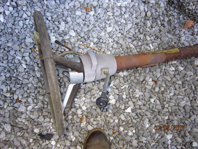

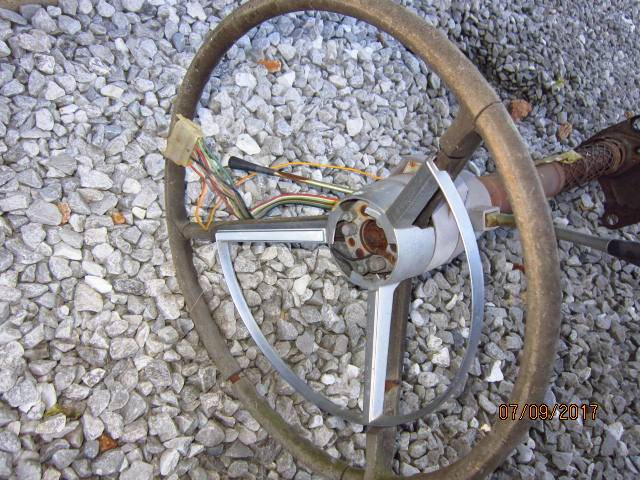

Your photos of the column show it doesn't have the collapsible mesh sleeve so its probably not a 67.
The firewall mount plate has four holes and a 65 has only 3 holes, so it looks like a 66 vintage.

OH never mind. I took a closer look at your pics on a PC. It does have the collapsible mesh sleeve. It wont work for a 65.
