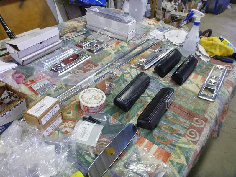

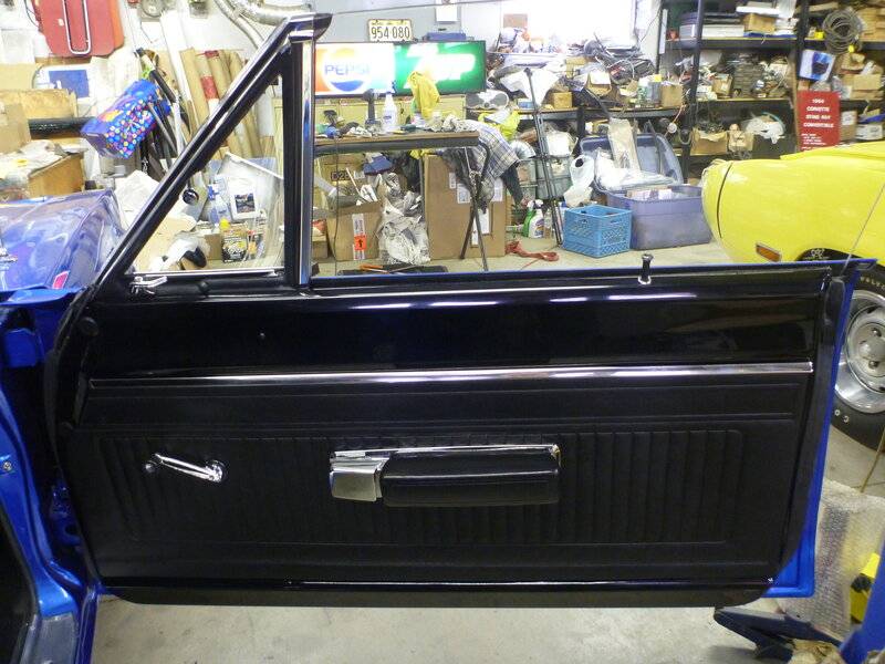

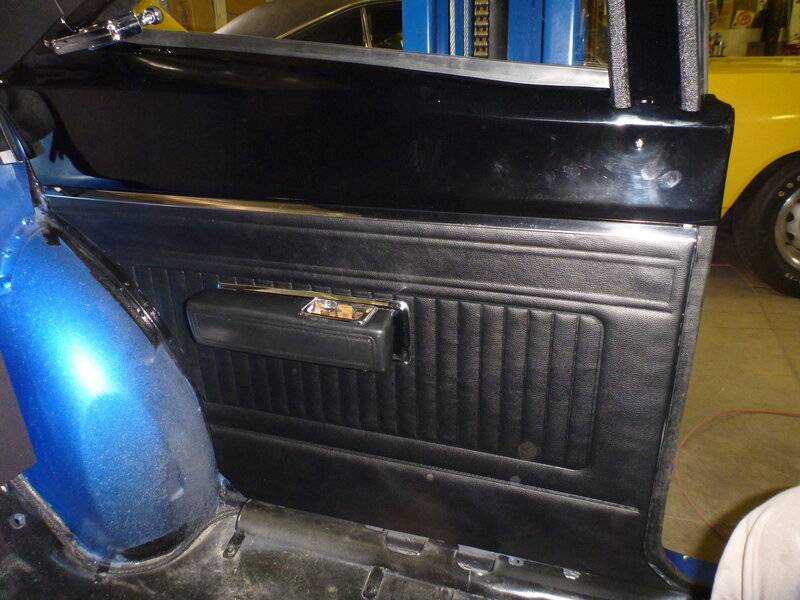

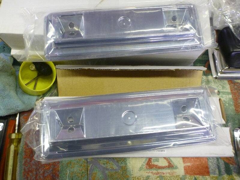

13's in the front, 9's in the back...

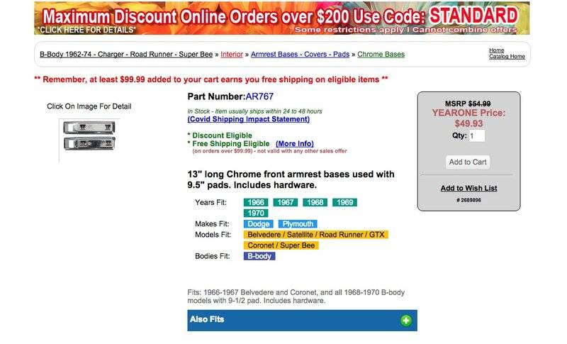

The arm rest pads are supposed to be 9 inch long for fronts and rears. The rears have the ash trays in them. The front bases are longer for the handle opening. 13 inch long front arm rest pads were that I know of, in C-bodies, Chargers, and 67 GTX .

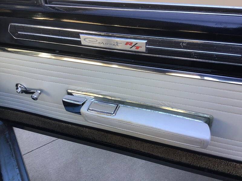

Add 67 Coronet R/T's to that list also for the 13" fronts.
Thank you gentlemen. I couldn't find anything definitive if there were differences in car options. Being able to ask you good people on FBBO has helped a lot. And I have Wayne's thread saved, just wish I had his awesome skill set too.:thumbsup:
Add '66 Belvedere and Satellite to that list as well.
Satellite (and Coronet 500) but not Belvedere (or Coronet 440).

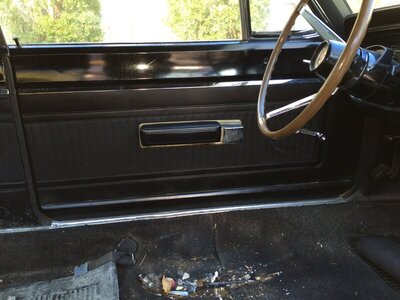

My Satellite and my Belvedere take the same parts. If I'm wrong I'd appreciate the correction.

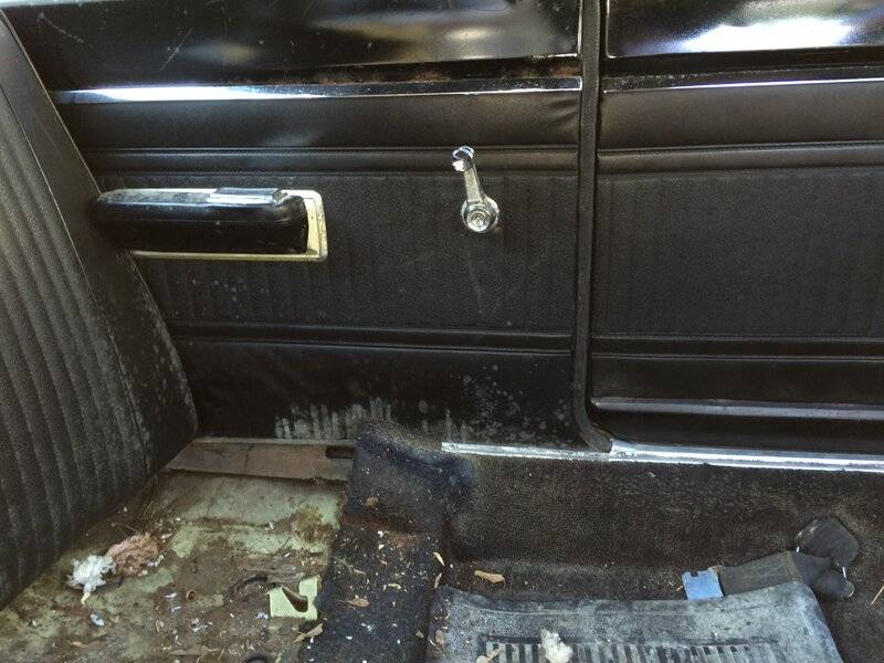

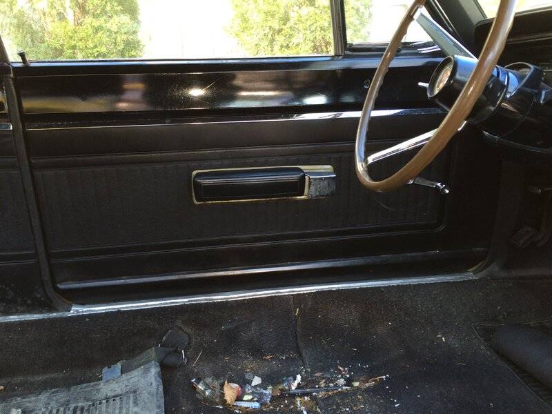

For 1966 and 1967 B-bodies the cars the take the 13” front arm rest pads are:
Satellite and GTX
Coronet 500 and R/T (with ash tray in RF on 67)
All chargers (unknown about ash tray in RF)
