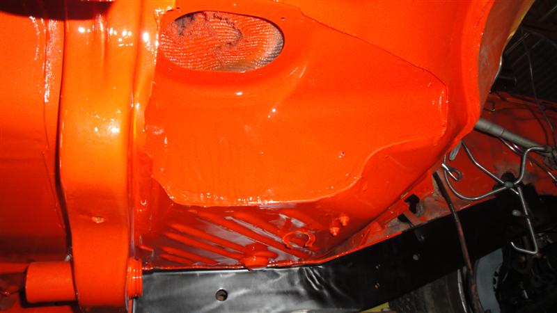

Has anyone converted a automatic to 4 speed? What I'm really after is a few pics of a original 4 speed as reference on where and how much to cut for the hump. Of course that would be a picture from underneath the car. 1970 Superbee is the vehicle I'm working on.

I will try & take a pic from underneath. I have the engine & trans out of the car rite now so it should show good. But my mom in ICU at the hospital at the moment so if I get the chance Il try & take a couple pics for you.
Thank you Low Hound. That's what I was thinking of doing. I just didn't want to run into a issue of not cutting enough out the floor. I have the hump and it does fit nicely over all contours like you said. Hope all goes well with your mom. God Bless.
Putting the 4 speed hump in was a very crude procedure at the factory. As you now know, the hump locates itself where it is supposed to go. I'm pretty sure they hend welded it in first, then cut the floor out from the bottom, that way you can use the hump as a guide when cutting.
I see you already have the hump and maybe everything else. If not you should check out the entire kit available from Brewers Performance. You will get a nicely prepared tranny and absolutely eveything you need.

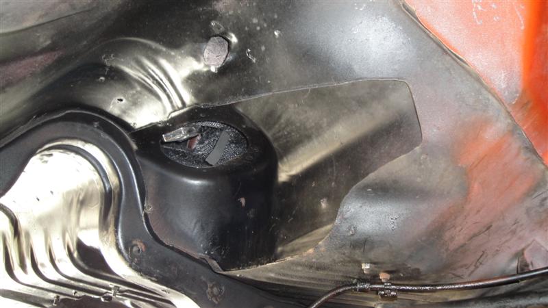

one more before paint that might help show install better
