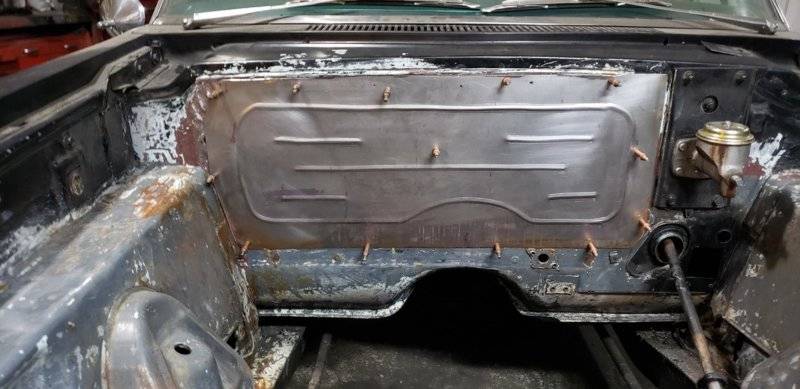

beings I removed the entire heater and controls I did figure on running the ignition and alternator behind the firewall to the right side. no rush, I'll muddle along. firewall- my welding because of vision is suspect wondering if I bolt it in with allan button heads would look stupid or? BTW-I really appreciate the idea's and suggestions offered here- I guess I can hire someone to do the welding, would it need to be welded in 100% around or many spot welds? as always your opinions matter. I tried to do a little bead work on the firewall BUT I have only a hand crank beader (harbor freight) on a wiggle ready stand , I am not thrilled with the result but its the only piece of sheet metal I had to do the job.

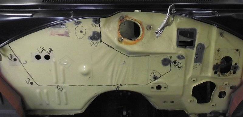

If you're cutting it out then it needs to be fully welded. Here's the section I want replaced in mine. I'll keep the heater holes and the bolt holes unless I can figure another way to hang the heater box. The wiring bulkhead hole will be filled And I'll probably make a m/c backing plate that follows the cowl line. I found a heater motor that is an inch shorter than the stock one so I can get rid of that bulge

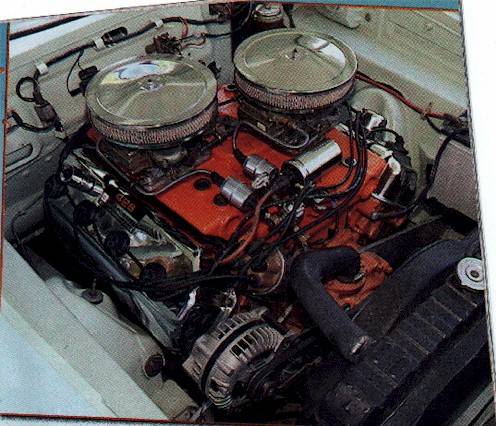

if the '64 had been that free of rust I'd not have done anything to it- but.. I looked back at a picture I took of my '62 Dart wagon with the 426 hemi and the stock wiring was minimal and clean enough to keep as it was. don't know why all the extra wiring on the '64 -and each seems to be going somewhere important.
