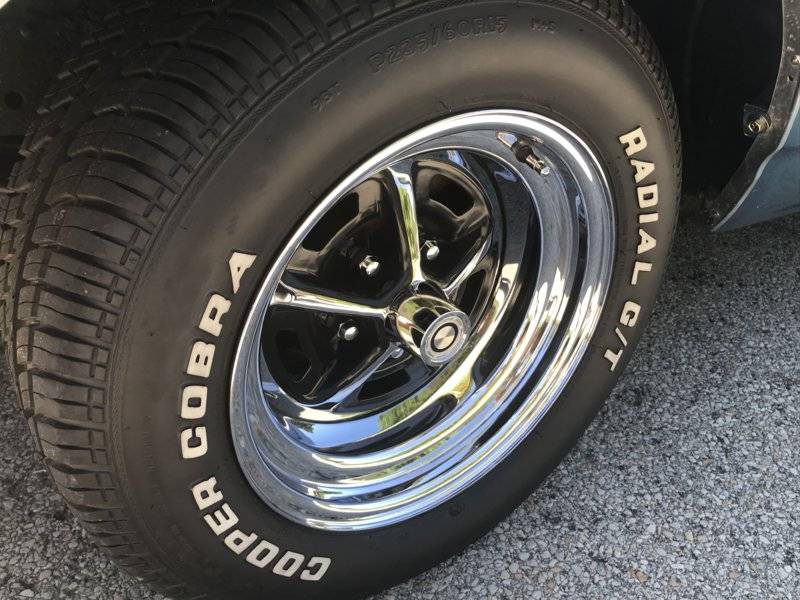

run taller tires
Excellent suggestion, I put 15’s on. But, the tires I chose aren’t very high and I wish I had chosen a taller tire for looks alone. Very good point, I know that. But, it slipped my mind until you mentioned it. Thank you
