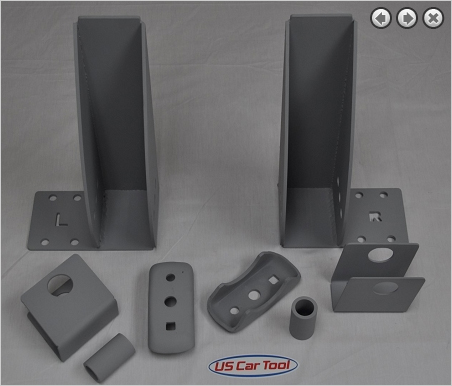

Personally, I love the kit made by US Car Tool. I like the idea of the additional support that mounts to the stock spring hanger. They have good instructions, I've never installed a kit, but purchased mine from them. I'll be doing a whole minitub and rear floor replacement first. US Car Tool also has a nice minitub kit, they're working on the early kits from what I've been told.

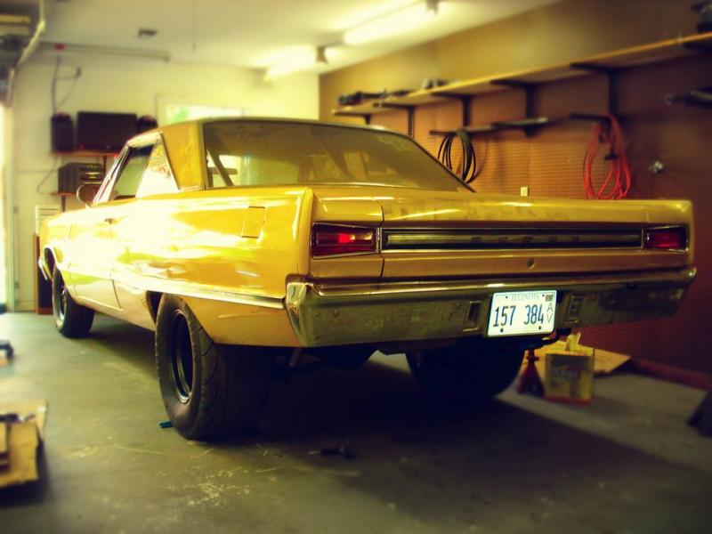

I have a 3/4 inch move in on my car using A body front spring boxes and 3/4 inch offset rear spring hangers. No wheel tubs and a a 10 inch Hoosier slick on an 8 inch rear rim. No cutting.
Not sure if that's what your looking for though...
image.jpgimage.jpg. I don't use offset shackles but you can see where you could by moving the box inward.
