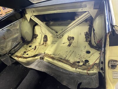

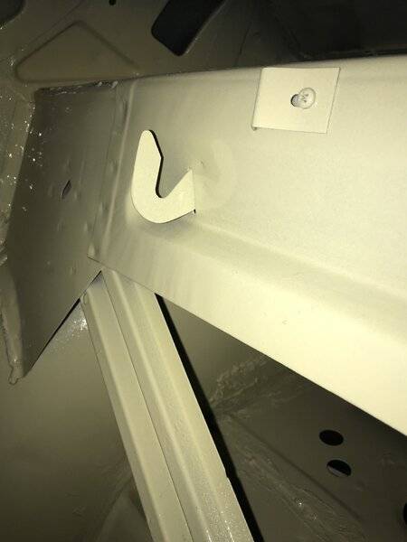

I have a 68 Satellite. I’m putting sound deadener and new wiring. After getting the bottom seat out.... pull out on the lower part of the back rear to release it, then lift up towards the roof to get it off the two upper hanger hooks. See pic. Zoom in on the 2 upper hooks and you’ll understand better. The hooks are on the back, way up near the speaker holes of the package tray. I’m just guessing it’s the same for your charger. Tip: take at least one of the back seat arm rests off to make it easier or it’ll get hung up on it.

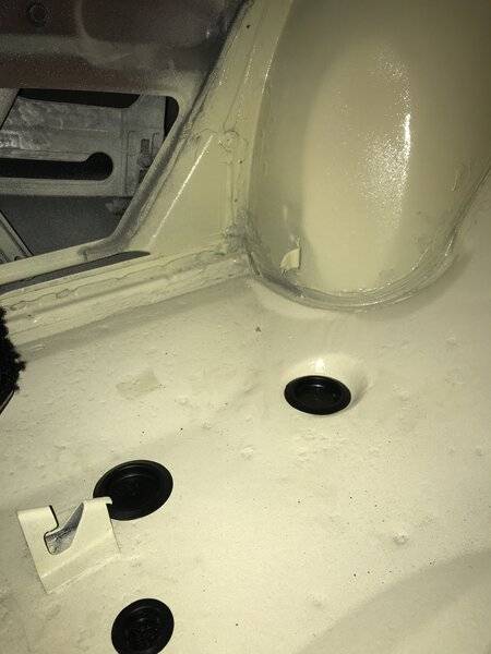

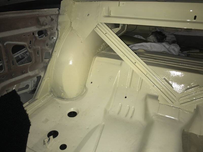

Here is a pic of my 69 Super Bee hooks. It’s been a long time since I pulled them out but I think the bottom has to come out first. I think. I know it’s a pain in the ***. At least for me it was.
Don't know if there's a diff but with my '63 you can't remove the seat 'back' without removing the bottom or at least getting it out of the way. Once the bottom is out, there are two brackets form the seat frame toward each end of the seat back that are screwed in, remove the screws then pull it up as there are tabs on the top to secure it there.
View attachment 1063744 View attachment 1063745 View attachment 1063747 Here is a pic of my 69 Super Bee hooks. It’s been a long time since I pulled them out but I think the bottom has to come out first. I think. I know it’s a pain in the ***. At least for me it was.
