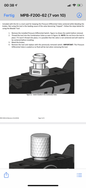

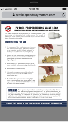

Thanks for the response. I had disc/drum before as well. But I’ll look call dr diff and make sure. Also, I finally figured out how to bleed brakes through the proportioning valve and why so many have problems with rear, and wit unequal pressures. Nobody talks about the PV brake bleed tool!!
This is what everyone needs and should be included in all brake kits imo. Fits into where the switch fits to keep the piston inside the proportioning valve from moving, during the bleeding.

There is no fluid coming out from where the switch inserts normally. The piston inside has rubber o ring seals on either end.
Can buy on summitracing or eBay. Called proportioning valve bleeder tool or pv tool.
So you just screw it in and do your normal bleeding? And that will allow more fluid to get to the rears?
Yes apparently this is what most get wrong, that they pump the brakes, hold it down, meanwhile shunting fluid only to the front and wonder why it’s not going to the back.
The pv tool will center the piston, so fluid can reach everywhere during bleeding.
