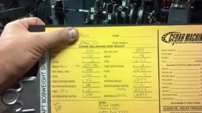

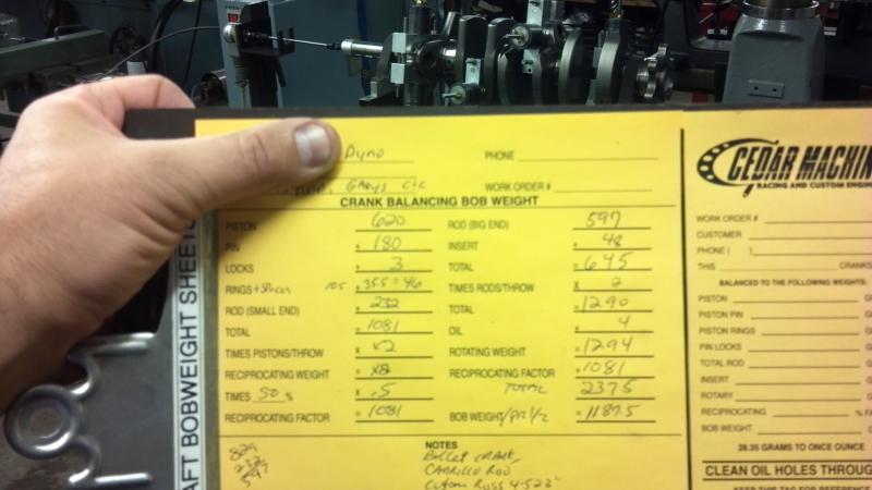

Here is what's represented on a bobweight for a 90° V8 using a 100% rotating and 50% reciprocating calculation. There are 4 bobweights on the crank.
The weight of both big ends of the rods.
The pair of rod bearings
4 grams for oil
The weight of one piston
Weight of one pin
Weight of one ring set
Weight of one small end of a connecting rod
Weight of a pair of circlips (if used)
Obviously, this is for a assembly with all parts that are weight balanced to each other.
This is a typical bobweight sheet. Sorry, it's a Ford i just finished :)
