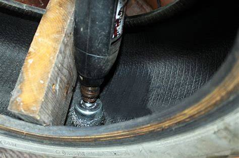

2) Although a tire tech may mark the position of the tire in relationship to the valve stem, after he patches the tire and mounts it in the same position as before, the tire will still need re-balancing (because of the addition of the patch).

Come on.. A tire patch that weighs one quarter of an ounce is going to imbalance a 45 lb tire and wheel ? Really ???
