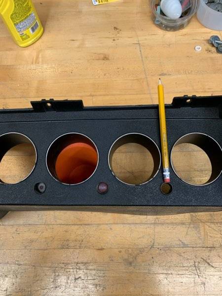

Helping a friend out with this instrument panel for a '71(?) Barracuda. What goes there where the pencil is pointed to in the picture? What goes to the left of the brake? Thanks!
Looks like the turn signal indicators.The brake one looks like it’s in the wrong
position the brake is all the way to the right and the other two are the signals
In the drivers position it should be: signal, signal, brake for E Bodies 1970-74.
