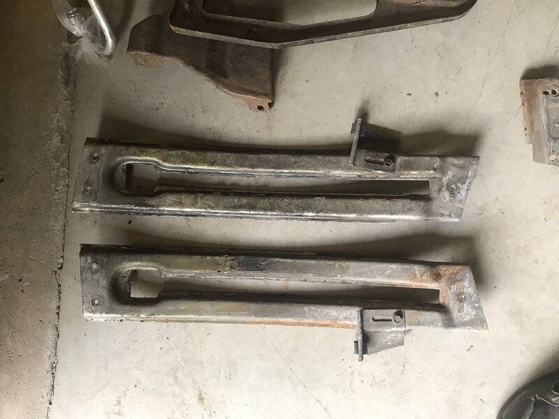

Close up of part #1

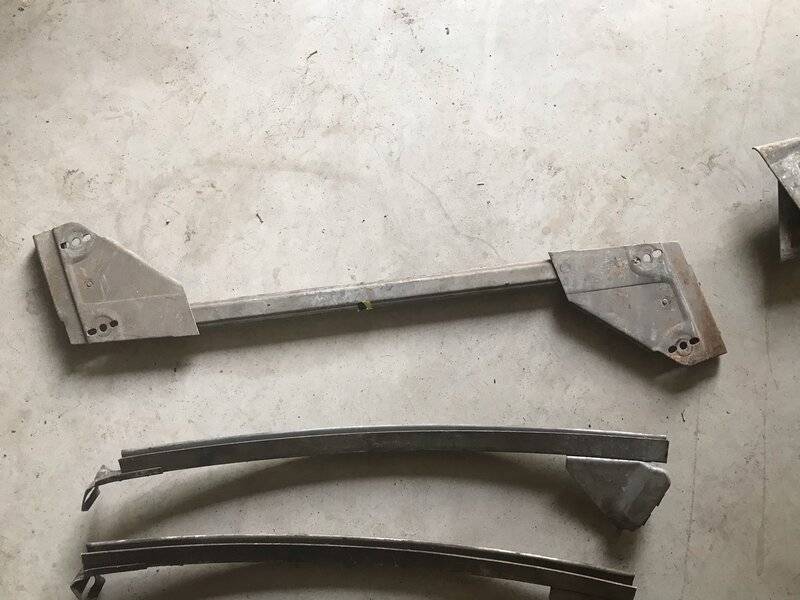

Close up part #2

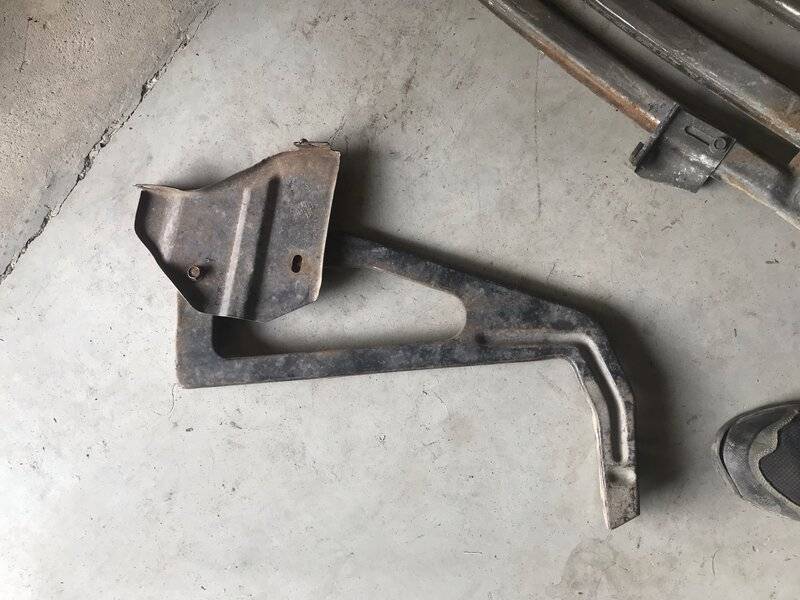

Part #3 (this one look like rails for windows)

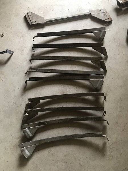

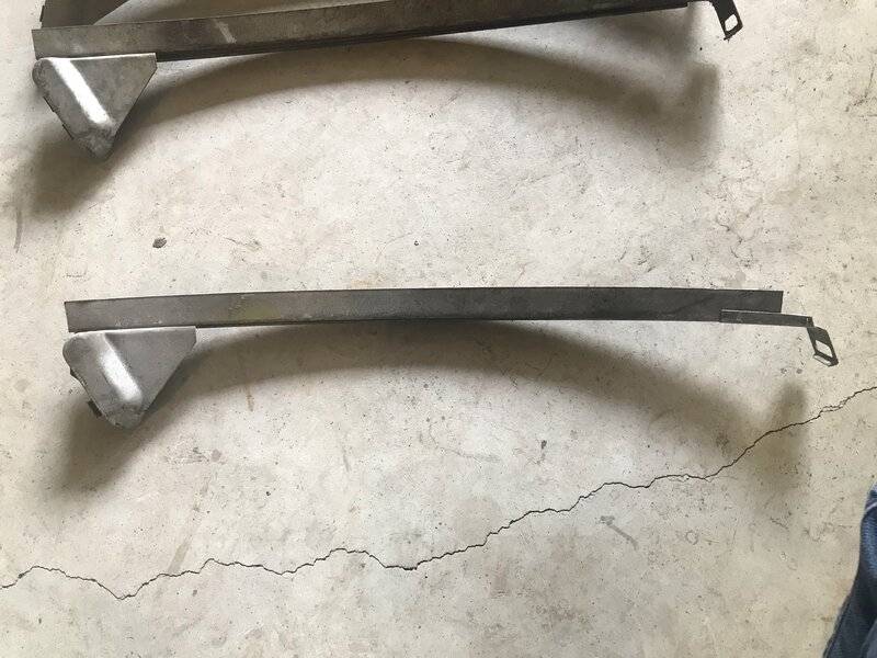

Part #4:

Never had a 73 apart, but I would bet you found the box with the window channel guides and supports in it.
From a 72 Charger appearence: #2 looks like channel that bolts to front window: #3 is rear window guides: plastic H clip on window rides in center channel, bottom bolt is single bolt & 2 bolts go on top, the 2 brackets are window down stops, adjust bottom forward/aft to get window adjusted correctly to seals. #1 appears to be window channels, fortunately didnt need to blow my doors apart so not 100% sure.
