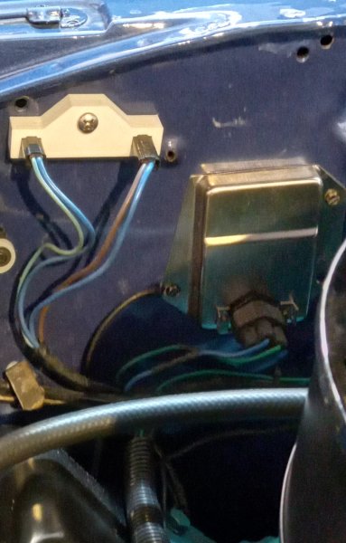

Show us a photo of your regulator. According to your name and avatar photo you have a 68 B body which should have the old points style regulator. If you replaced it you may have bought an electronic one that looks like the old ones. The electronic ones require a perfect ground and like all charging circuits, no voltage drop or excessive resistance in the charge wire circuit. It must see full battery voltage or it will overcharge constantly. 15v. is really too much. Low to mid 13's is my comfort zone. Contact @HALIFAXHOPS. He may have a NOS regulator for you. Back when they were made in the US and good quality.
Yes I am running an updated regulator . Had the setup on the car for 10 years . It's possible it has been running this way for a while ? There are no other problems you wouldbt know unless you checked it.
Most are packed up. Do have some of the two pin ones NORS out.
I bought the solid state in a points regulator case type because too lazy to drill holes in firewall.
Also ran a wire from regulator mounting screw to ignition coil mounting bolt.
Works good with original 35 amp alternator.
