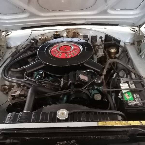

Im not necessarily after dead nuts correct cables ( Pos and Neg )
Just a quality set of cables I can replace these hardware store ends ,,,,,,which are but ugly

Looks like some home made stuff on that car already. Red wire over the booster. Negative cable too long and runs behind the battery.
I like to cut off the wires to the relay and signal wire to starter and affix that on to a new cable of the correct length, then it looks and works right.
Oh yea,
Some serious cleanup and detailing is in its future . Along with get the a/c operational
The fan shroud looks really weird. Proper reproductions are available.

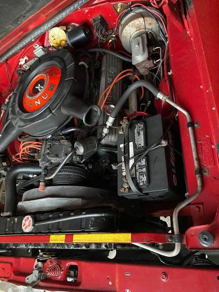

Rock Auto specials. Not red but nice ends. The small wire on the positive gets spliced into the original.
