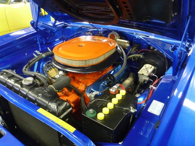

What is too high battery for a 69 Coronet N96 hood?
Can a person use a 8 inch tall battery and be ok?
Looking to put a AGM in
I think it is a group 27 battery that comes stock in the 440 cars. 12.5 x 6.75 wide x 9.37 high
Well that’s good
Concerned about clearance for ramcharger
Can any one else confirm this?
Looks like I am good with a 8 inch battery height!
Thanks 68 RT
So is that where yours sits at
Dadsbee 9.375 I see you have the
ramcharger l am figuring over all height which includes post!
Just making sure before I buy a AGM battery.
Thanks for the info
