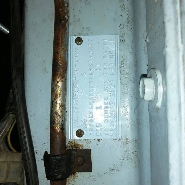

1967 had a carryover Light blue metallic. DD1.
Ditzler Chrysler code
13043 BAY2B4
You should be able to have any place that handles PPG paint, mix it up. Your fender tag should show DD1.

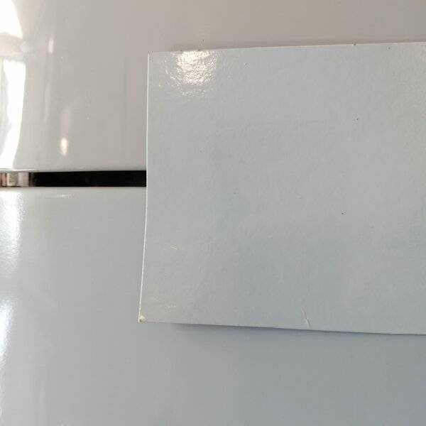

Here is the spray out of the new paint. The passenger rear quarter was repainted after the rest of the car, and is a bit darker, so we tried to match that colour. The biggest scratch is on the quarter. Came out close enough for touch ups. I primed the battery tray on the weekend and will probably paint it next weekend.

Paint code is CC1, but they didn't have any way of cross referencing that code to their current products.

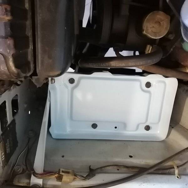

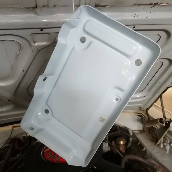

Paired the tray and support today. A little bit lighter but close enough for a part that is 90 percent hidden.
The fender tag shows the difference in the colour a bit better.
It turned out really well. Of course its going to be lighter and more vibrant, but it will age up a bit if you oil it, wipe it clean with some residue.

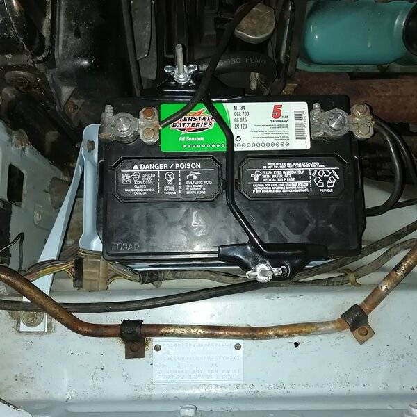

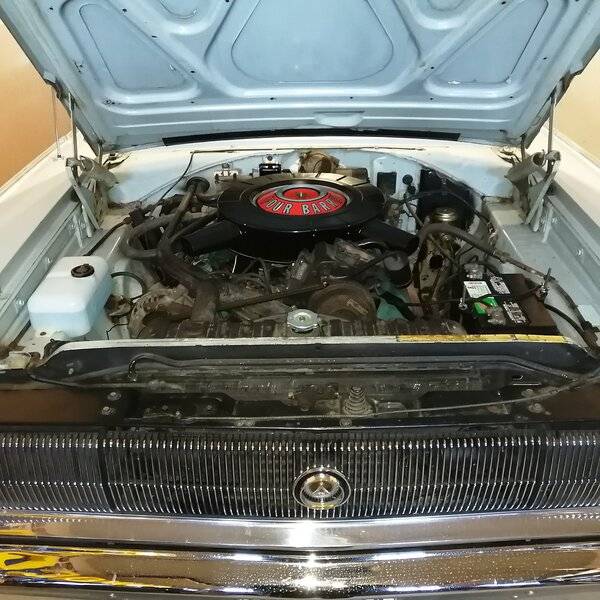

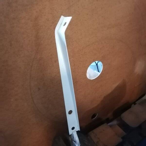

Got the old tray out and the new one in today. Didn't realize how much they had cobbled up to make the wrong one fit. Good news is it fit the way it was designed to. Bought a correct hold down to replace the parts store one.
Still needs some more clean up but looking better than when I got it.
