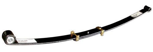

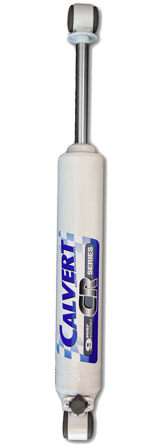

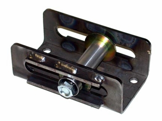

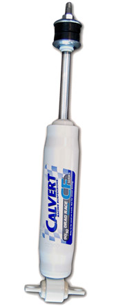

:iamwithstupid: Calvert/CalTracs will help for sure... You do need some weight transfer, to get her to hook, get it to squat in the back & lift the front, CalTracs will help for sure, good adjustable drag shocks, battery in the trunk & the Mono spring & a set of {Correction} reiforced "front" hangers/perches & Rear leaf spring sliders {see drawing}from Mancini Racing, will also help, especially if you don't get the Mono leafs & use the stock leafs, but work very well with the Mono leafs too... you need to get it up on the converter, launch at a higher, to get that usable power, just rolling into it, the suspension isn't working for you, just spinning & to ET well, the 1st 330-ft is almost everything when trying to improve your ET's.... Good luck & have fun Happy New Year

I have my Caltracs on now..... installed everything late fall but have had limited time testing. 90-10 shocks up front is in the works first thing this summer, bad part is I just installed new KYB Gas Adjust shocks when I put the car together..... I had just a couple trips to the park and back, and down to the gas station to put fresh fuel and stabil in it before winter hit.
I have never heard anyone using the sliders on the front spring segment mount???? How does the rear stay put with sliders in the front?
I used AFCO sliders starting back 15 years or so ago on the late-model dirt track rear suspension,,, and they REALLY freed up the rear end!

Caltrac's work good. i run sliders, in the REAR where they belong. i don't really think those are necessary but i did it while i was at it. like stated, lots of front end travel is key, cut down the upper control arm snubbers, and some good loose shocks. i ended up going to adjustable strut rods and uppers with heims to aid in the weight transfer. my dart is pretty nose heavy though. my car hooks pretty good from a roll on the street, but it'll still spin from a dead dig. not a issue on a prepped racing surface. they take a little time to get dialed but its worth the effort. Make sure you re-enforce the spring perches or put the calverts on, i found out the hard way when mine bent.

DOOOOH my bad, I should have proof read my post, I was referring to reinforcement plates on the front spring hangers & roller/sliders on the rear like in the pitcher I posted earlier, I should have proof read my post, some how, I deleted part of it, ooops... I've corrected it now, MRE roller sliders they go on the rear, sorry for any confussions... The pitcher should have made it clear...
