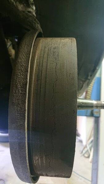

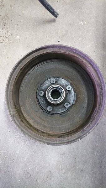

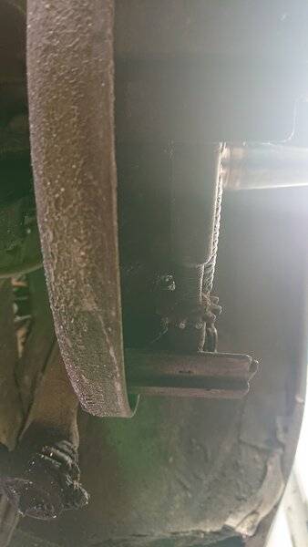

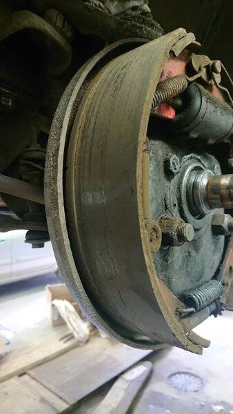

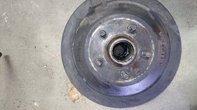

Hello guys
A small update on this.
It seems indeed that in some point somebody has managed to swap 11x2,5 drums on front, they were swedged and all, and looked factory made.
Brake shoes were also 2.5 but of course being too narrow they had worn guite funny.
I managed to get hold of drums here in Finland so got the car running and driving once again.
To my disappointment I do have fair amount shaking when braking so new drums were not very good quality. I was thinking of getin them turned if that will help.
Does someone know to which tolerances i should aim?
