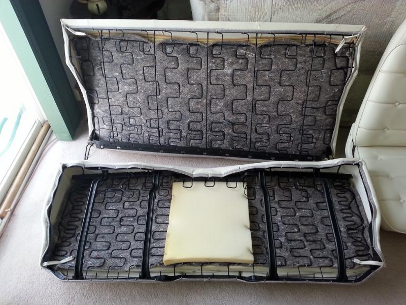

I had local upholstery shop do mine, there are two layers of foam, and they also added jute between the foam and the springs to keep the springs from tearing into the foam. Here is what they look like.
