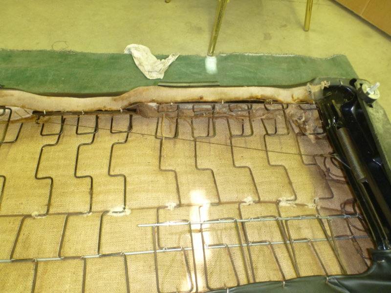

Hey guy's, I have a 69 Super bee with bench seat and have a question on the springs that goes underneath for the return mechanism. I'm sending a picture and was wondering if these are the correct springs? Thank you, Dave!

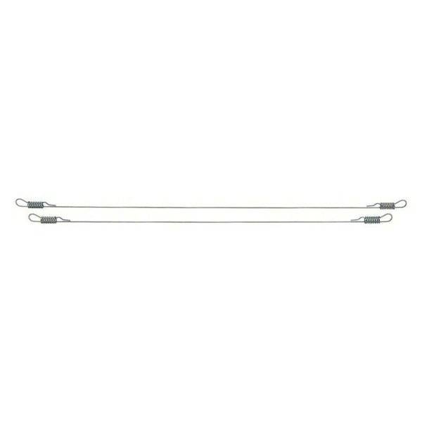

Those aren't "springs", they are release cables (wire actually) that go from the drivers side lever to the passenger side track release. The "spring" you see is just the retaining sleeve.

Thank you dadsbee! But will that retaining cable reach from one side thru the hook and then to the other side? Or is that why there are a two of them in the package?

Because those are short & therefore they are for Bucket seats....
Well like my Wife has always said, how do you expect me to know the length if you don't put a tape beside it for reference!
..as I showed, there is only a SINGLE wire on a bench seat.

So it looks like my cable is bent out of shape and not even fed through the hook. Looks like I'll have to look for
the proper cable. Thanks for all the help and comments guy's! Dave!
