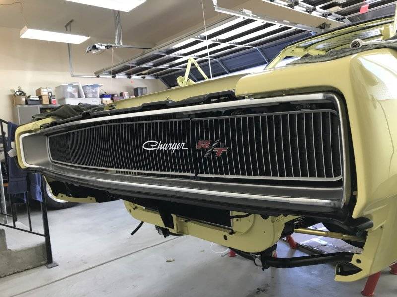

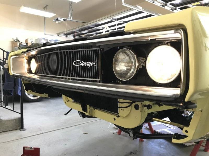

Here’s one that came on the market after I purchased mine. It’s $200 cheaper. It looks like an easier install.

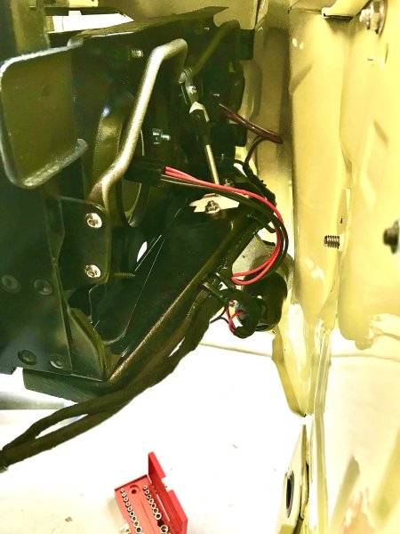

Where did you hook your power wire up to?
The trigger wire (green wire from the box) hooks up to the green wire on the hi/low beam floor switch. The red power wire I hooked up to an aux. fuse block coming direct off the battery. I added the fuse block because I had other components needing 12v. I put the control box in the same place the vacuum canister was under the battery. All the wire harness laid out pretty well from there.
