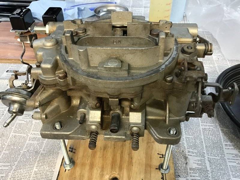

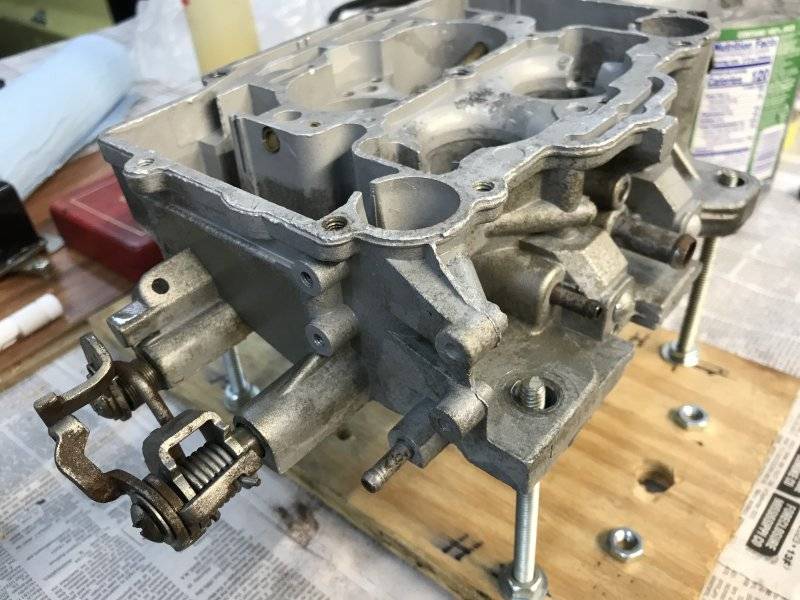

I used this solution.
I’m not sure how well it works compared to other products. I got quite a bit of sludge in the bottom of my cleaner and it didn’t seem to darken the aluminum. I believe these were before and after pictures.

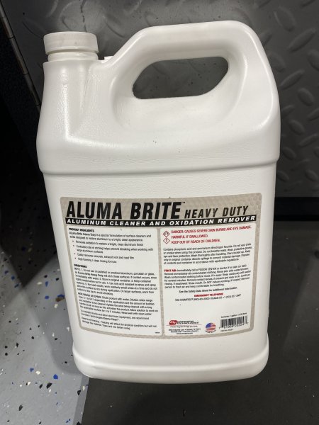

So in case this helps someone this is by far the best product to use in an ultrasonic cleaner to restore a brighter finish to aluminum and clean. Not expensive and it has to be heavily diluted and doesn’t take long at all. Minutes not hours.

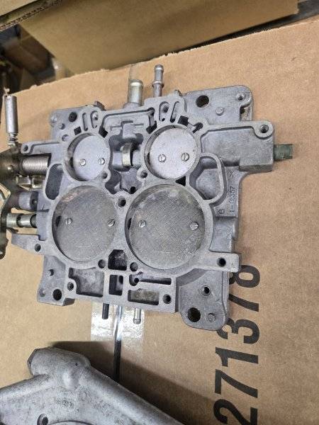

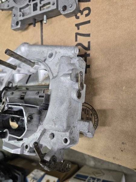

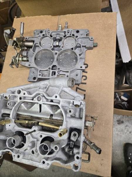

This was a crusty TQ that I ran through it.
You can see that the throttle bores need more hand cleaning, and that the base and top come out different colors.
I just attributed the color difference to different casting batches.
