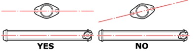

What I want to do is get the March Performance swap out for the Alternator and power steering brackets and pulleys. The one with the 2 separate belts. But it says you can't use the style water pump housing where the thermostat housing isn't parallel to the brackets.

What are they talking about ; 'Thermostat housing parallel to the brackets'? Both right and left inlet housings have the thermostat in the same place.

Sorry parallel to the radiator.
NOTE: Big Block Mopar brackets kits require that your engine have a thermostat housing in which the bolt holes run parallel to the radiator.
I have never (ever) seen a big block housing that was not parallel to the radiator. Must be from some sort of weird application like an industrial engine or possible marine application.
