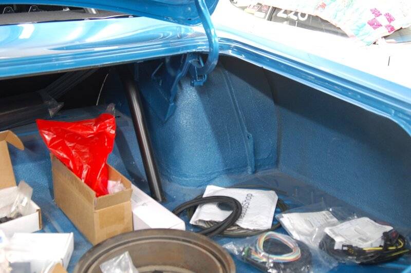

Sounds good Andy. If you could tell me What size are those wheels are and backspacing, Tire size and if those are stock tubs? Id really appreciate it!
Rear wheels are 15 x 10. Not sure on backspacing, maybe 5.5 inches. Tires are 315/60-15. Car has been tubbed.

That will be a fun ride. Minitubs look great! With the roll bar it looks like your planning on some track time...
Any e.t. goals?
700 hp, 4000 lbs, should go low 11's or maybe high 10's if everything works just right.

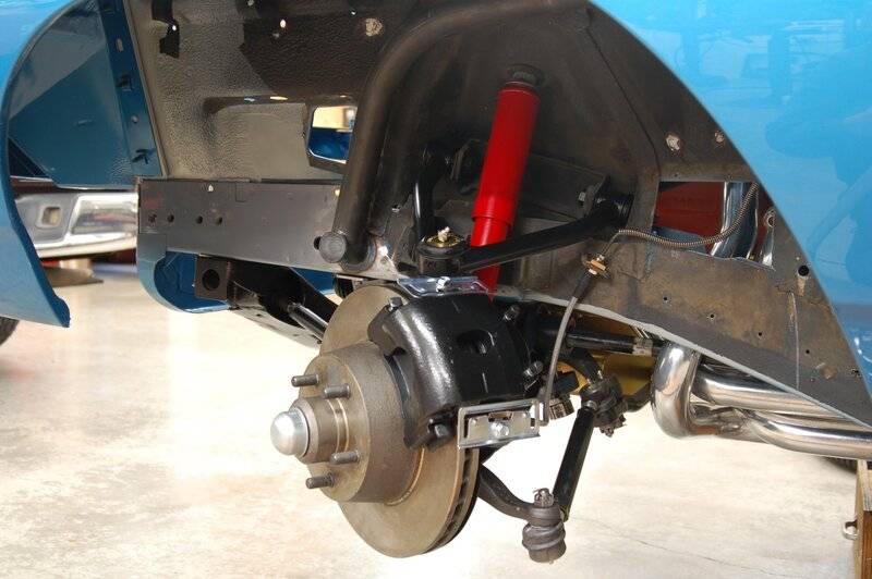

This is a street car. Full interior, undercoating, full exhaust, etc. plus the cage. So it will be 3900+ with driver. It has a glass hood, aluminum heads, mini starter, aluminum water pump housing, etc. but that doesn't offset the added weight. It also has a dana, 11 inch rear drum brakes. The front has discs but they aren't lightweight, they are the factory 11.75 setup with cast iron calipers.
