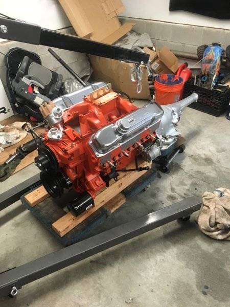

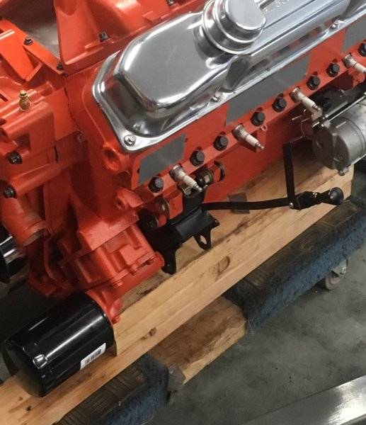

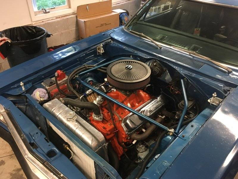

Pretty much box stock stealths on my 4fitty1 - gone through by a machinist.
Looks like an iron headed tree 80 tree.

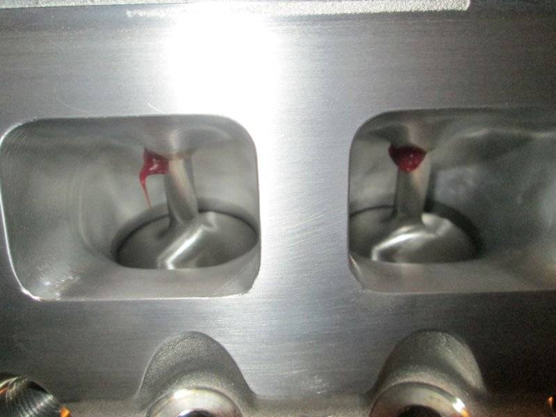

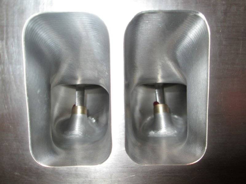

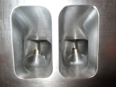

Promaxx 'Shocker' CNC'd 84cc heads. No issues whatsoever. I purchased these from Promaxx directly and they worked with me on spring requirements.
