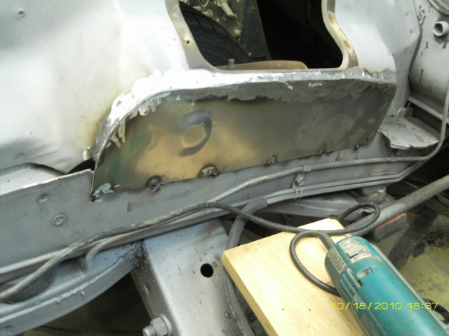

Wow what a tard mistake sorry guys ..... This is a 73 satellite that I am cloning into a Roadrunner it was a factory 318 car and I am putting a 440 in it. My 73 roadrunner parts car has a 440 in it but I don't know if the K-frame has been changed . My parts car was a factory small block car also that somebody put a 440 in. I already trimmed the passenger side lower inner fender to clear headers.

If your 440 hits the inner fender pm me and I will send you a picture of the cutout and the correct dimensions I took from an original 73 GTX BB car. Did not have any oil pan problems may have already been changed out to correct pan.
