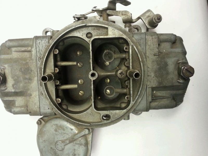

Holley used to make a 3 barrel in 950 and 1050 sizes, basically a four barrel that had the two secondaries turned into one giant oval plate. Hard to get parts for but there are usually a couple on ebay.

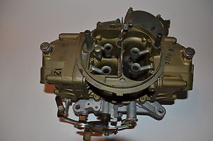

950cfm {some 1050} 3bbl Holley #3916 #4915 #4604 among others IIRC, was a great old vac. sec. carb, "tuned properly" originally used on BB's {some Nascar for a short time}...

The 3 BBLs with the dump tubes are 1030 or 1050. I have one on my carb wall that I'm thinking of putting on a stock 318 with a 4 BBL to 2 BBL adapter.
Budnicks what do you think? I'm thinking one of these (3 bll) might just be the ticket for my project! Close to a six pack in CFM, vac sec. and a single carb. Or do you think I'd be better off with the 870 street avenger? Thanks!!!
Can be made to work, I wouldn't scare you off of getting one, but IMHFO it depends on what it's going on, how many cubes ? what RPM range ? what manifold ? what camshaft ? what ignition ? etc.... CI X RPM Divided By 3456 = CFM I had good luck with them way back in the early to mid 80's IIRC, they were good carbs for the time... Now you can get a Quickfuel parts, much better adj. metering billet blocks, different Acc. Pump, or discharge squirters/nozzles & cams, jet extensions, Vinton needles &seats, better gaskets, also some adj. secondary jet plates, with replaceable/interchangeable jets for great adjustability {pro-maxx if Quickfuel doesn't list it} & update it some too... If you have enough air flow & exhaust flow & then need that much CFM it will work just fine, you can also detune it some too, more than one way to skin a cat...
