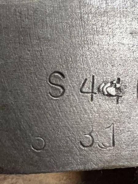

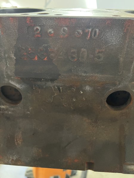

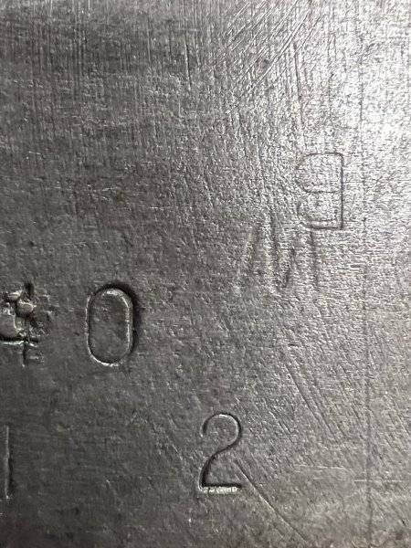

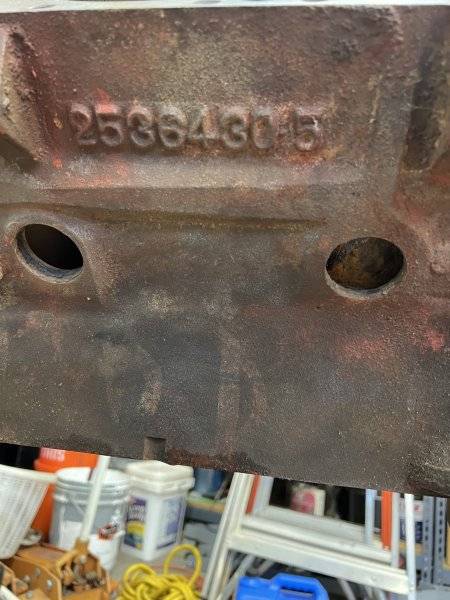

I am finally going to start building a motor for my sons 69 satellite.
I bought a 70 RR in 1973 and had that car until 1997 when our home burnt down. My car was in the garage and could not be saved. I was able to salvage the motor and Dana rear end. It was a 6bbl car with 4:10 dana. I also save the rear springs.
Any way the numbers on this block have always confused me. Help would be appreciated.
Thanks.
Just a guess on the S440 that the S might designate that it was an over the counter service replacement block. Looks like it was cast feb of 1970.
Feb 9th 1970 !
Service / warrantee engine
... I'd love that engine.. :p
Ya...that's cool...haven't seen a block with that stamping before! Most likely a service/ warranty job. Someone was enjoying the 4:10 Dana a bit, and popped the original short block

I bet a salesman or someone at the dealership broke it. He was the only owner. I was the second. I will try and get a better photo. It looks like there are punch marks that cover other marks?

So I guessed correctly, service short block or engine built on March 31st on the 2nd shift. I suspect a short block as there is no HP on it, as the heads dictated that. If you have the paperwork on the car, when was it built?
2563430 -Casting number for 66-72 440 block.
- 5 = 5th core revision/freshening of the casting mold used
Block cast 2-9(?)-70
S = 440 = service replacement
Appears to have been assembled 3 31 (1970) 2nd shift.
Please notice this pad is not stamped HP as the original assembly would have been. Meaning we do no know what internal components this particular assembly may have come with. The gut's from the original 6bbl motor may have been used but we do not know what was used from this particular stamp.
B = .010 undersized rod and main bearings.
W = possibly water tested.

One other thing caught my eye. The valley area looks to be painted. I never saw a production, service, or warranty engine with a painted valley.
