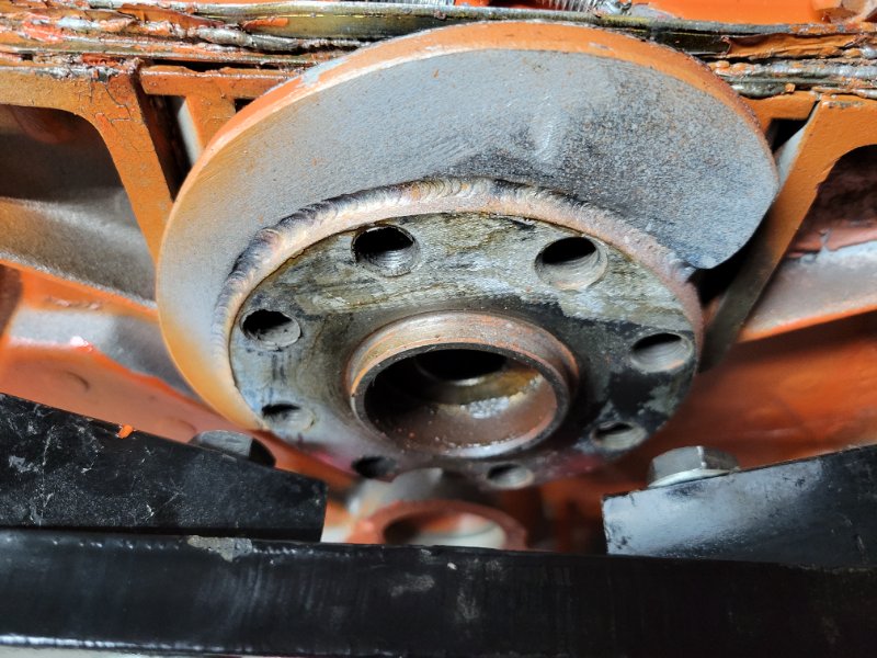

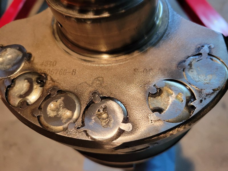

Heavy rods. I put H-beams in mine. Pictures of the weight that was removed, a little over 4 lbs. May be why he didn't want to balance it. I really liked that weight that was welded to the flange!
He's probably not wrong.
I have a billet hemi crank (cracked top alcohol crank) with fourteen slugs of mallory in it.
And an original maxwedge crank with weights welded to the counterweight
Changing from the domed ashtrays that somebody thought were pistons to 12 to 1 Arias, reduced bobweight by more that 400 grams. I used a steel 440 crank instead.

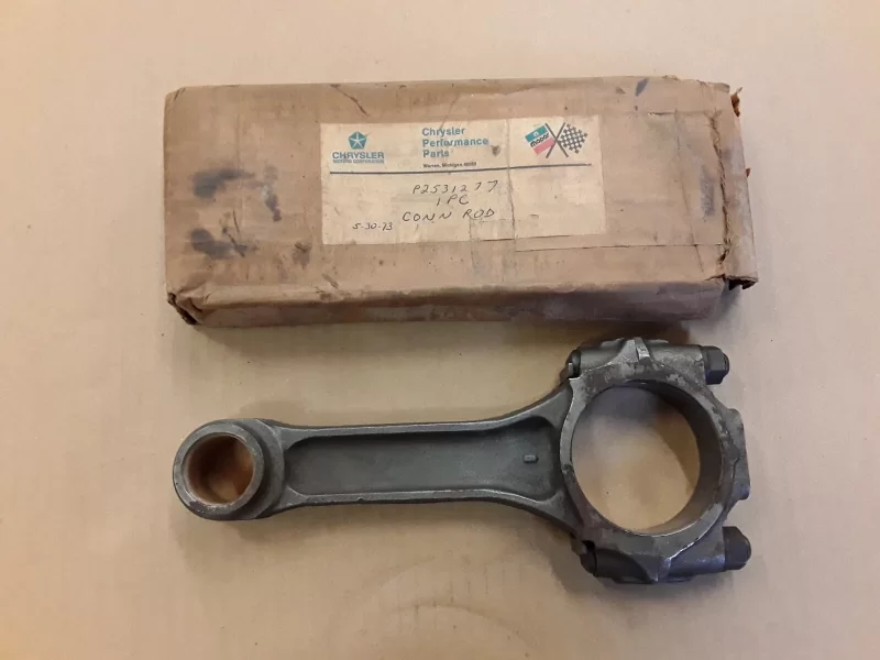

Its a 426 wedge engine with Nascar rods and custom pistons.

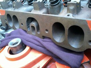

One off casting iron street heads from Mother Mopar.

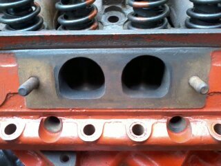

Ovalport intakes and D-port exhausts with a passenger car crossover unlike the max-wedge.

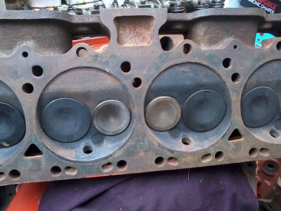

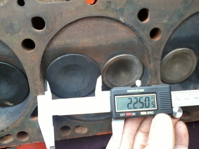

They were cast by mother Mopar in the late sixties to overcome the hemi ban.
Passenger car ''W1 heads'' never made it into production.

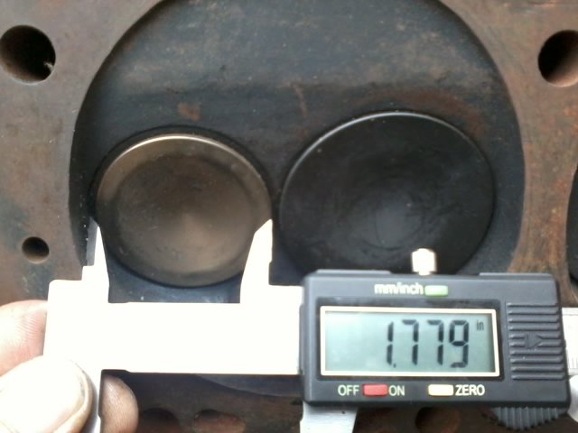

2.250 intake valves and 1.780 exhaust valves nice.
Extra cooling passages like the late MH heads too.
That's a BIG BLOCK head?!?
Sure doesn't look like any bbm head I've ever seen.
Looking at the port pics, I thought it was a W2 small block head.
