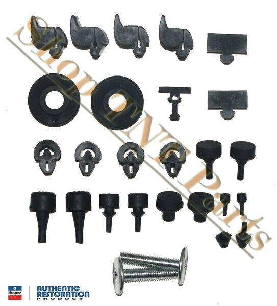

Is there an illustration to show where the body bumper kit pieces go? Lots of ours are missing so I can't match them up.
what car? If you bought a kit it should tell you. I believe mine did.
There was no illustration for my 65 either. Put all the bumpers on the bench and then start looking where they go; front and back of hood, doors, glove box, ash tray, etc.
There are probably more bumpers in the kit than you will need.
is this the kit?
top 4 fender,2 round ones and screws hood adjusters,4 under are door,2 small and 2 big for trunk also two for back of hood next to cowl then you have ashtray and glove. Hope that helps
